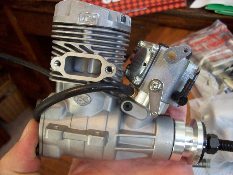

Wysłany: |17 Gru 2010|, o 09:49
To lepszy może być ten silniczek
I zadziwiające parametry na taką pojemność
Specifications:
�Type: 2 Cycle Air Cooled Gasoline Engine for airplane use only
�Displacement (cc): 14.93cc
�Bore and Stroke (mm): 27.8mmx24.6mm
�Carburetor: Walbro WT series (Diaphragm & Bytterfly Valve)
�Maximum Output: 3.2HP / 12000RPM
�RPM Range: 1800 - 13000 RPM
�Ignition: Auto advanced RCEXL DC-CDI (RoHS and CE Certified) with special spark plug cap
�Spark Plug Type: 1/4x32 Rcexl
�Ignition Power: DC 4.8 Volts (4 cell NiCad or NiMH battery)
�Lubrication Oil: 2 cycle Engine Oil
�Break-in fuel oil ratio: 25:1 (4%)
�General use fuel: 33:1 (3%)
�Recommended Propellers: 13x8-15x8 (two blades)
�Weight: 635g (without ignition and muffler) 824g complete (with ignition and muffler)
